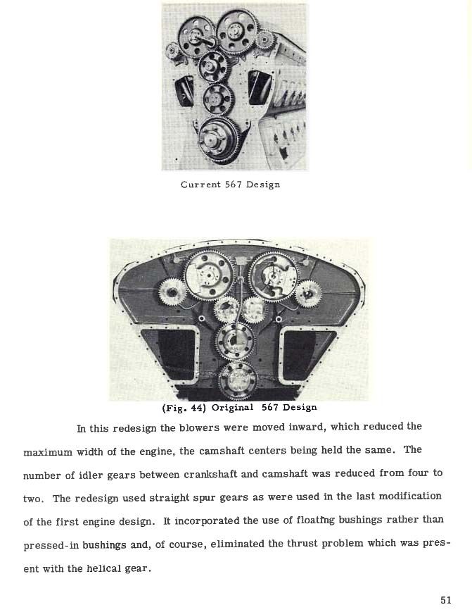

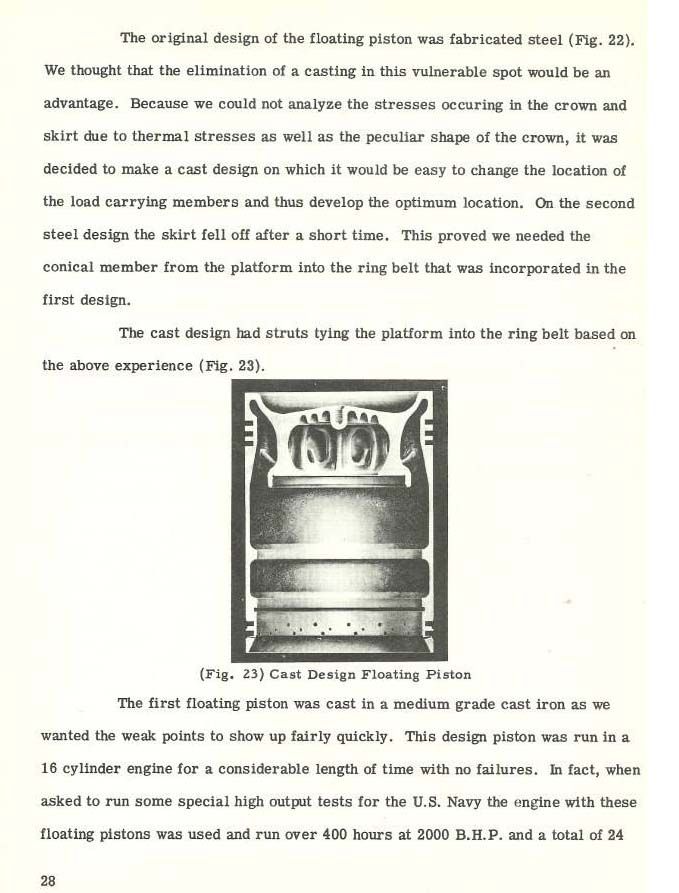

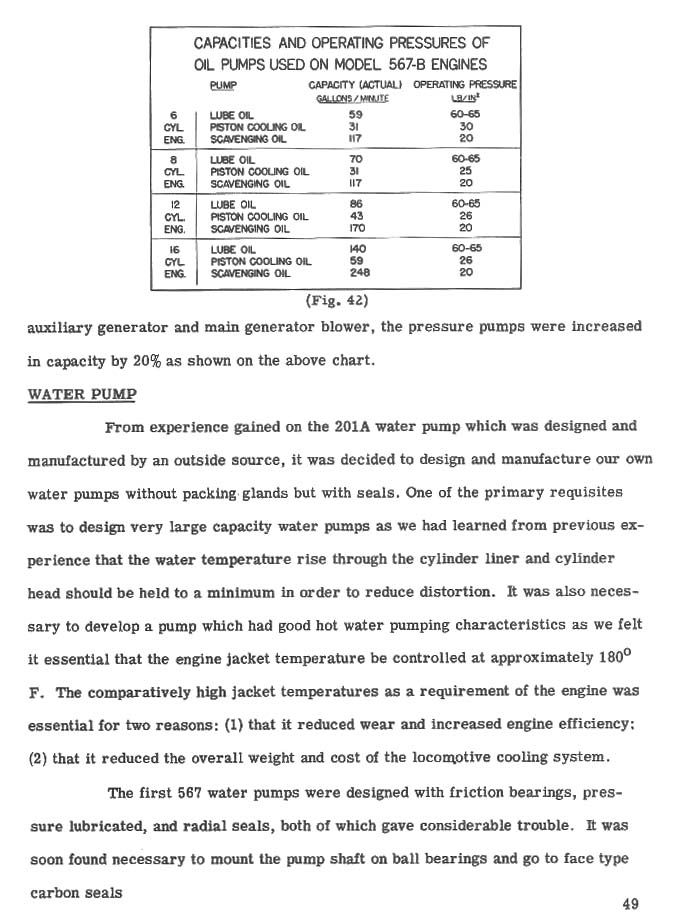

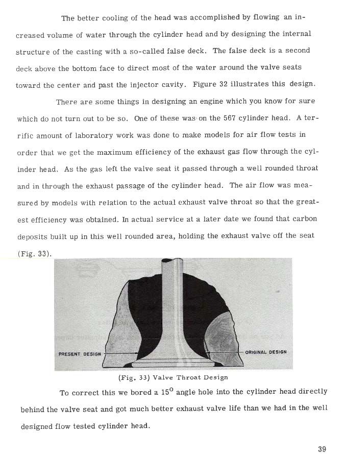

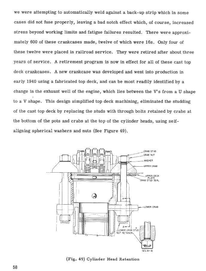

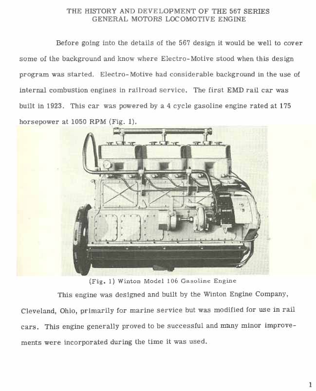

EMD 567-motors historia berättad 1951. Sid 1 - 10 (Järnväg allmänt)
av BD, Monday, July 01, 2013, 19:19 (3557 dagar sedan)
EMD 567-motors historia berättad 1951. Sid 11 - 20
av BD, Monday, July 01, 2013, 19:22 (3557 dagar sedan) @ BD
EMD 567-motors historia berättad 1951. Sid 21 - 30
av BD, Monday, July 01, 2013, 19:25 (3557 dagar sedan) @ BD
EMD 567-motors historia berättad 1951. Sid 31 - 40
av BD, Monday, July 01, 2013, 19:27 (3557 dagar sedan) @ BD

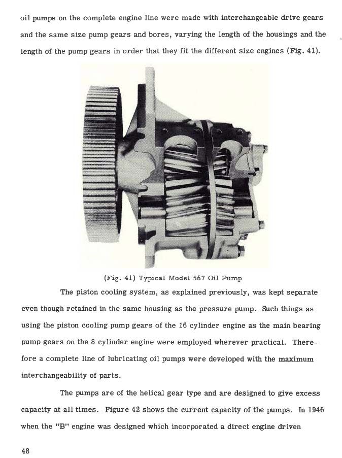

EMD 567-motors historia berättad 1951. Sid 41 - 50
av BD, Monday, July 01, 2013, 19:30 (3557 dagar sedan) @ BD
EMD 567-motors historia berättad 1951. Sid 51 - 60
av BD, Monday, July 01, 2013, 19:34 (3557 dagar sedan) @ BD
EMD 567-motors historia berättad 1951. Sid 61 - 70
av BD, Monday, July 01, 2013, 19:36 (3557 dagar sedan) @ BD
EMD 567-motors historia berättad 1951. Sid 71 - 74
av BD, Monday, July 01, 2013, 19:38 (3557 dagar sedan) @ BD

Mycket nöjsam läsning. Ett exempel från sid 8: "To mention the parts with which we had trouble in Chicago would take far too much time. Let it suffice to say that I remember no problem with the dip stick." :-D
